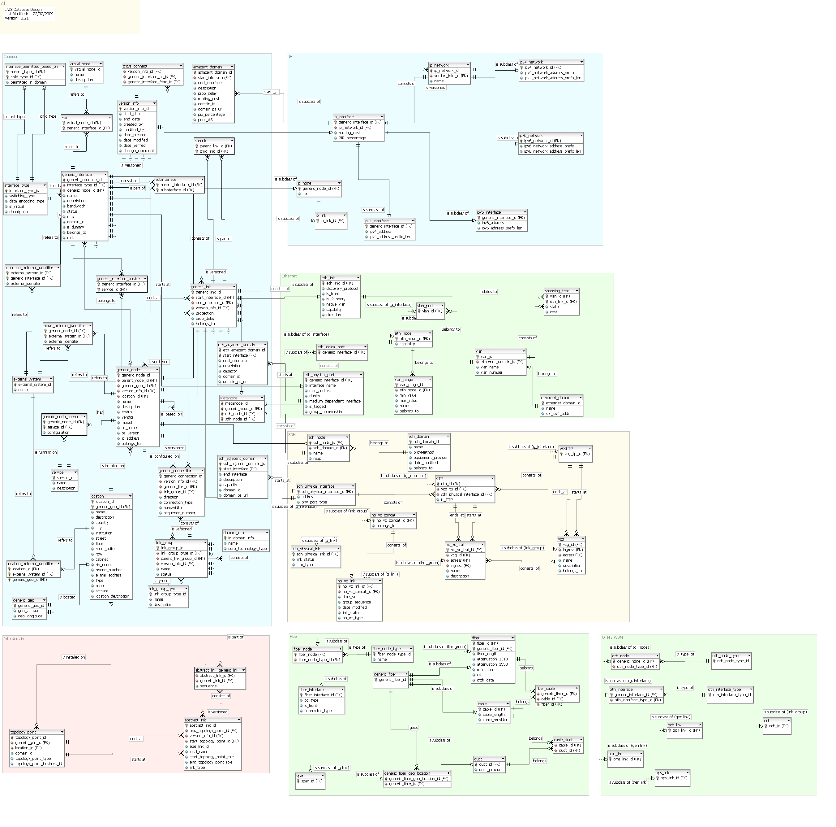

Do you have any pointers to more information on common Network Information System (cNIS)? I've found several presentations/PDFs, but am interested in seeing the RDBMS schema or UML model... I can't seem to find it. Thanks! -Chris -- Chris Tracy Mid-Atlantic Crossroads (MAX) Office phone: 301.314.6655 GPG key: 0xB3B9C93D

The only official document I know of is: http://www.geant2.net/upload/pdf/GN2-07-045v4-DS3-13-1_common_Network_Inform... This contain some schemas at the end. In addition, I also got some UML images, cnis_erdv0.14.png and cnis_erdv0.17.png. I still don't know if these are public, so I'll mailed Anand about that. Regards, Freek

It is public: http://forge.gridforum.org/sf/go/doc15137?nav=1
Hi Chris, I have attached a diagram of the most recent cNIS schema. The purpose of cNIS is to act as a common network topology database with sufficient detail to fully represent the main technologies included in the networks of the GEANT partners. The schema is made up of a common table to support generic nodes, interfaces, links and connections, and additional tables for each of the main technology types - IP, Ethernet, SDH, OTH/WDM and Fibre infrastructure. The cNIS development now incorporates the IP and SDH technology tables and is being used to retrieve the GEANT Juniper IP and Alcatel SDH topology (I am not aware of the state of implementation of other technologies). I have attached a copy of the XML schema file for SDH for reference. Regards, Guy ----------- Chris Tracy wrote:
