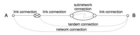

Hello all, During the last OGF we have had very productive discussions, and I think we have made quite some progression. However, one thing that we were not able to agree on was terminology for links/circuits/connections/tubes. Enclosed with this email are two figures that I created based on terminology and figures in ITU-T G.805[1]. If you're interested in G.805, Freek has written a very readable report on it[2], and we have also written an article about modelling multi-layer networks[3]. Figure 1 shows several terms: - *connection point* is any point that can make a connection (the circles in the figures) - *network connection* is the terminated connection from A to B. - *link connection* is a direct connection between two connection points. - *subnetwork connection* is a connection between two connection points that you can not or do not want to describe the details of. - *tandem connection* is a concatenation of link connections Figure 2 shows a multi-layer network connection between X and Y. If we start from X, we first encounter an *adaptation* to a lower layer. Then we go through another link connection. At that connection point we use *multiplexing* to adapt to a lower layer to connection point A. Then we use the same network connection as in figure 1 to go to B, where we go through *multiplexing*, a *link connection*, and an *adaptation* to arrive at Y. Note that the multiplexed connection can also be viewed as a link connection on a higher layer. The same goes for the connection between X and Y, which is a link connection at the highest layer. And because the connection is therminated there, it is also a network connection. Please share your thoughts on this terminology! Jeroen. [1]: ITU G.805 standard: http://www.itu.int/rec/T-REC-G.805/ [2]: Introduction to ITU-T G.805, Freek Dijkstra et al.: http://staff.science.uva.nl/~fdijkstr/publications/G805-introduction.pdf [3]: A Multi-Layer Network Model Based on ITU-T G.805, Freek Dijkstra et al.: http://staff.science.uva.nl/~fdijkstr/publications/G805_Multilayer_Model.pdf -- My email address has changed to <vdham@uva.nl> (The science has disappeared from my address, but I'm still doing it)

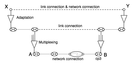

Both a network and a link connection seem to be 'connections between two points'. You say that in one case it's terminated and in one case it's not. Is 'terminated' a property of the link or is it a property of the connection point (or the node the connection point is attached to, depending on one's definition of connection point)? What differentiates a link whose contents gets demux'd to an higher layer vs. a link whose contents get routed at the same layer? A subnetwork connection is a link or network connection that you view as opaque, correct? I.e. I've got a connection between these two points, i either don't know or don't care how it's constructed. If so, would "opaque connection" be a more clear description? A tandem connection is a network or link connection that spans multiple connections? How does it differ from a network connection which in figure 1 also spans multiple connections? Cheers, Aaron
It's a 'property' of the connection point -- basically it says that connection is terminated there (these connection points are end-points for a certain layer and are called "termination connection points" or "TCP").
A network connection is a special case of a tandem connection: it is a tandem connection between termin
I can't answer the question if I were to follow G.805 to the letter. To be annoyingly precise (which G805 is): First: in G805 the term "link" is only used for the physical wire/fibre. What we are talking about is a "transport entity across a link", which is called a "link connection". Second: link connections are never routed or switched. Easiest is to compare link connections and tandem connection with graph theory: - link connection = single edge - tandem connection = path (a sequence of edges) you seem to talk about tandem connections (paths) rather than about link connections (links). So I take it that you mean to ask:
What differentiates a tandem connection whose contents gets demux'd to an higher layer vs. a tandem connection whose contents get routed at the same layer?
The difference is that a tandem connection that gets demuxed to a higher layer must thus be terminated at the lower layer. Thus, that is a terminated tandem connection, which is called a "network connection". (to be even more pedantically correct: the end-to-end connection before termination is called a "network connection", while after termination it is called a "trail")
Sure -- I'm certainly not saying that I'm a big fan of every word G805 come up with. However, there is a slight difference: a subnetwork connection is a opaque connections *through a given network*. To recap: * link connection is a direct (or atomic) connection on a layer (think: link). * tandem connection is a sequence of link connections (think: a path or a segment of a path) * network connection is a tandem connection that will be terminated (think: a end-to-end path) And for the real G.805-adepts: * trail is a terminated network connection (think: end-to-end path) Regards, Freek -- Disclaimer: This is an e-mail message. Use your own judgment about its value. If you do not have such common sense (e.g. you are a lawyer) or like to see crap like warranties, intended-audience or as-is statements, then the following applies: you do not understand the concept of satire and are not allowed to read this e-mail.
